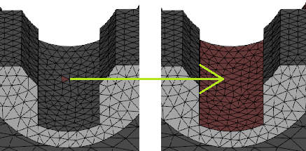

Use the
Triangles on Same Surface tool to select all triangular elements on the same surface.
Use this tool, for example, to select all triangular elements on the same surface before applying boundaries condition, or editing a surface. The elements are selected if there is connectivity, even if the properties of the elements are different.
Triangles on Same Surface tool is supported for the following mesh types:
Midplane
Dual Domain
() and select
Triangles on Same Surface from the drop down menu.
