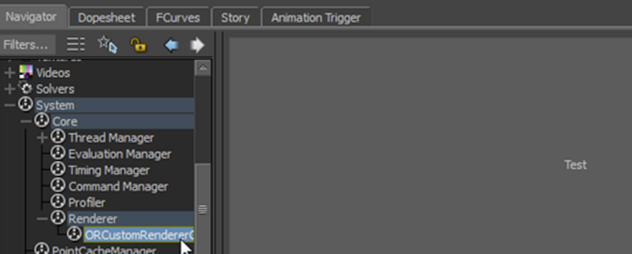

You can access the custom renderer plug-in from the user interface in the following ways:
Core
Renderer as shown in the following figure.

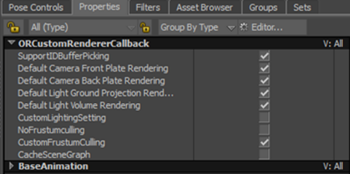

You can design your own asset settings panel for the custom renderer.
The property view changes to display the renderer’s properties when you select the renderer from the Renderer menu.

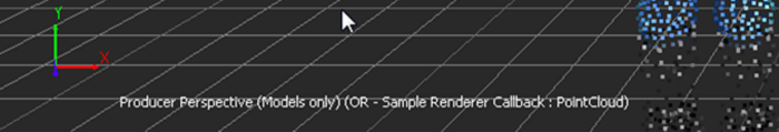

Additionally, the camera title is expanded to include the custom renderer name and its current preset setting, if selected. The following figure shows how the renderer and preset are displayed alongside the camera title in the viewport.
