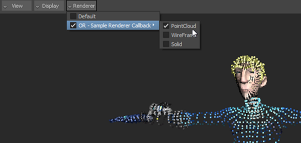

You can use the custom renderer to replace the default renderer by integrating an OpenGL based shader plug-in into the MotionBuilder viewport. You can use this feature to develop your own rendering solution that suits your requirements.

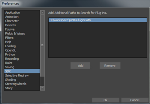

After the project is built successfully, the resulting library is saved in <yourinstallationfolder>/bin/x64/plugins. Make sure that you have write access to this folder, or configure the Visual Studio project setting (or Makefile in Linux) and specify the destination folder as one of the additional plug-in directories. You can add additional plug-in paths either by setting the MOTIONBUILDER_PLUGIN_PATH environment variable or by using the Preferences dialog as shown in the following figure.
The plug-ins that are saved in these specified folders are automatically loaded at startup.
For more information about accessing the custom renderer, see Accessing the Custom Renderer in the User Interface.
