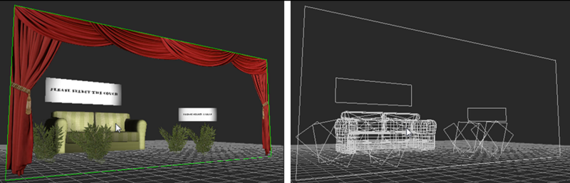

As shown in the following figure, you cannot pick through the transparent portion of the curtain to select the couch behind it in this mode.

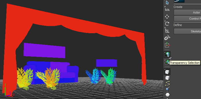

Color Buffer Picking
The new color buffer based picking overcomes the disadvantages mentioned in the Selection Buffer Picking section.
The concept is quite simple as follows:
  1. Draw all the visible models with the regular rendering pipeline.
  2. Use the model’s unique ID instead of filling the color buffer with the regular shading result.
  3. Read the pixel value back from the color buffer under the mouse pointer.
  4. Translate it back to the model’s unique ID, and find the corresponding model.
The color buffer filled up with the model's unique ID is shown in the following figure.

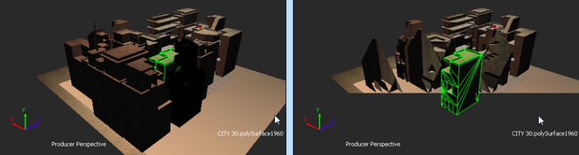

The color buffer selection solved the transparency picking issue effectively. However, you might still face issues in a large and crowded scene that contains many objects. A new selection interaction mode called the Z Depth Selection can select an object, and engage the Hide Front behavior (Shift+1), so you can clearly see the selected object rendered on top of all the other objects. The other objects are culled back to the selected object’s farthest point from the camera. The custom renderer needs to display this effect in the same way as the default renderer.
The following figure shows a scene with a selected object (on the left) and the same scene with the Hide Front behavior (on the right).

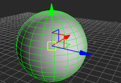

By default, a green wireframe is superimposed over the regular shading on the selected model as shown in the following figure.

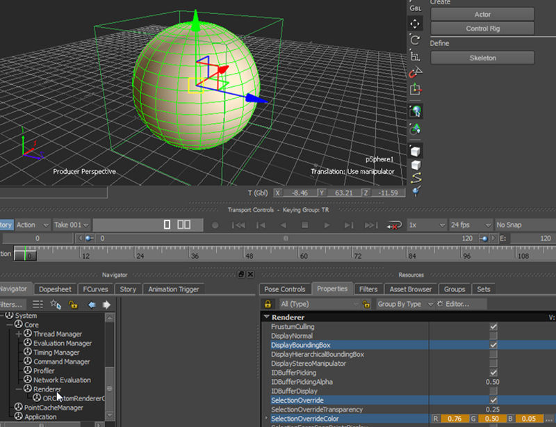

However, you can add additional visual hints. For example, bounding box or a semi-transparent color overlay as shown in the following figure.
You can access and modify these setting through the UI (using the property view of the global Renderer object) or through the SDK. You can also remove or replace the default wireframe selection highlight by calling the FBObject_Register() and FBObject_Unregister() functions using the parameters group name render/utilityshader/ogl and entry name SelectionShader respectively.
