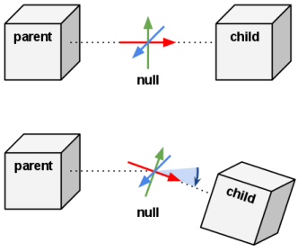

To create a joint in the scene, we first require at least three models, as depicted in the image below. The parent and child models are used to identify the extremities of a joint. The null model in the middle represents the point around which the models will rotate. The parent and child models are typically connected to a Rigid Body Physical Property to allow them to react to physical forces and collisions (see Rigid Body Physics).
The Joint Physical Property object is used to constrain these models to act as a physical joint. An instance of Joint Physical Property is created via FBCreateObject() using the Asset Browser path 'Browsing/Templates/Physical Properties' and the 'Joint' entry name. A null model is first connected to the Joint Physical Property via FBConnect() to define a new point of rotation. This generates an FBComponent within the Joint Physical Property whose name corresponds to '<null_model_name> Joint'. The parent and child models are thereafter connected to this new FBComponent's 'Connections' property via FBConnect(). This process is outlined in the following code sample, taken from the example below.

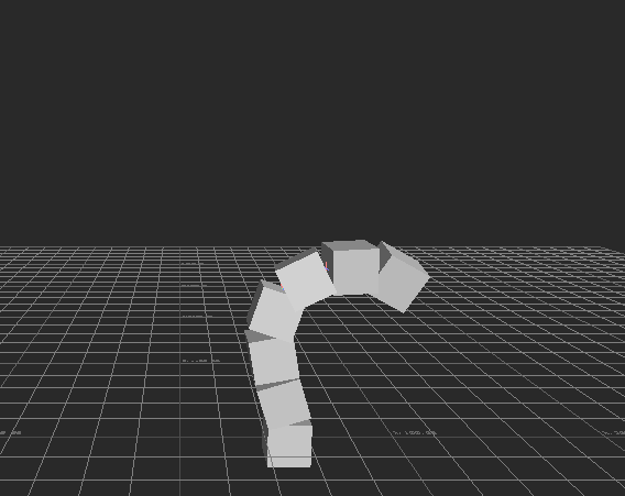

Program Summary: The program below begins by creating a chain of cube primitives, arranged in a sequential parent-child hierarchy. The base cube of this chain is passively rooted on the ground plane and every other cube is assigned an active Rigid Body Physical Property.
An instance of FBModelNull is inserted between each parent-child pair in the cube chain to identify each joint's point of rotation. A single Joint Physical Property object is then used to constrain the chain's movement. Lastly, the Physics Solver's 'Gravity' property is set to (0, 9.81, 0) to invert the force of gravity in the scene.
