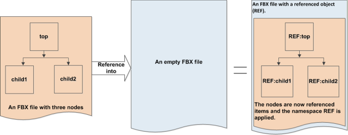

The namespace is a proper object. Namespaces are used for separating the referenced
items from the scene items. When a file is referenced, it is represented as a reference
object, which is a type of namespace. The following figure illustrates how a file
is referenced.
