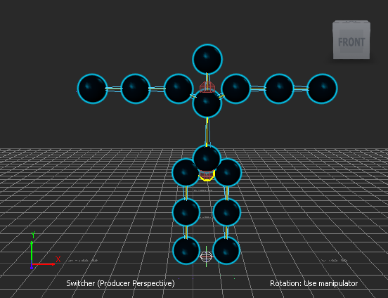

The function createSkeleton() in the script below uses a custom "jointMap" data structure as a template to create a hierarchy of FBModelRoot and FBModelSkeleton. Two skeletons are added to the scene, but we do not bind their joints to instances of FBCharacter. As such, the joints of these skeletons are not constrained to move like a biped.
from pyfbsdk import * # In the following skeleton template, the "LeftUpLeg" # has "Hips" as its parent, and its local (x,y,z) translation is (15, -10, 0). jointMap = { #jointName, (parentName, translation ) 'Reference': (None, ( 0, 0, 0)), 'Hips': ('Reference', ( 0, 75, 0)), 'LeftUpLeg': ('Hips', ( 15, -10, 0)), 'LeftLeg': ('LeftUpLeg', ( 0, -30, 0)), 'LeftFoot': ('LeftLeg', ( 0, -30, 0)), 'RightUpLeg': ('Hips', (-15, -10, 0)), 'RightLeg': ('RightUpLeg', ( 0, -30, 0)), 'RightFoot': ('RightLeg', ( 0, -30, 0)), 'Spine': ('Hips', ( 0, 40, 0)), 'LeftArm': ('Spine', ( 20, 10, 0)), 'LeftForeArm': ('LeftArm', ( 30, 0, 0)), 'LeftHand': ('LeftForeArm', ( 30, 0, 0)), 'RightArm': ('Spine', (-20, 10, 0)), 'RightForeArm': ('RightArm', (-30, 0, 0)), 'RightHand': ('RightForeArm', (-30, 0, 0)), 'Head': ('Spine', ( 0, 30, 0)), } ############################################################### # Helper Function(s). # ############################################################### # Create a skeleton in a T-pose facing along the positive Z axis def createSkeleton(pNamespace, pColor): global jointMap skeleton = {} # Populate the skeleton with joints. for jointName, (parentName, translation) in jointMap.iteritems(): if jointName == 'Reference' or jointName == 'Hips': # If it is the reference node, create an FBModelRoot. joint = FBModelRoot(jointName) else: # Otherwise, create an FBModelSkeleton. joint = FBModelSkeleton(jointName) joint.LongName = pNamespace + ':' + joint.Name # Apply the specified namespace to each joint. joint.Color = pColor joint.Size = 250 # Arbitrary size: big enough to see in viewport joint.Show = True # Make the joint visible in the scene. # Add the joint to our skeleton. skeleton[jointName] = joint # Once all the joints have been created, apply the parent/child # relationships to each of the skeleton's joints. for jointName, (parentName, translation) in jointMap.iteritems(): # Only assign a parent if it exists. if parentName != None and parentName in jointMap.keys(): skeleton[jointName].Parent = skeleton[parentName] # The translation should be set after the parent has been assigned. skeleton[jointName].Translation = FBVector3d(translation) return skeleton ############################################################### # Main. # ############################################################### FBApplication().FileNew() red = FBColor(1, 0, 0) skeleton1 = createSkeleton('mySkeleton1', red) skeleton1['Reference'].Translation = FBVector3d(-100, 0, 0) green = FBColor(0, 1, 0) skeleton2 = createSkeleton('mySkeleton2', green) skeleton2['Reference'].Translation = FBVector3d(100, 0, 0)

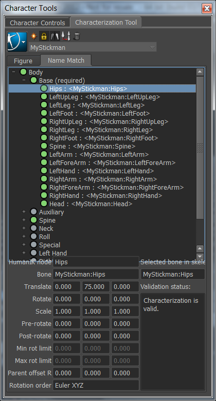

An FBCharacter is said to be "characterized" if a minimal hierarchy of FBModel has been assigned to the "Base" (required) character slots. The following list presents the names of these required character slots: HipsLink, LeftUpLegLink, LeftLegLink, LeftFootLink, RightUpLegLink, RightLegLink, RightFootLink, SpineLink, LeftArmLink, LeftForeArmLink, LeftHandLink, RightArmLink, RightForeArmLink, RightHandLink, HeadLink. The image below shows a valid characterization of the required character slots.
When the required slots have been associated with a joint in a skeleton, the FBCharacter.SetCharacterizeOn() function may be called with the True parameter. When a character is successfully characterized, an inverse and/or forward kinematic control rig may be created using FBCharacter.CreateControlRig(). To display and use this control rig, set the FBCharacter.ActiveInput property to True.
