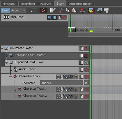

Run the manipulate_story_folders_and_tracks.py script to see how the story tracks are organized into folders (FBStoryFolder) and how you can manipulate the FBStoryFolder. For example, you can make the FBStoryFolder appear collapsed or expanded, mute all the tracks in the FBStoryFolder, and so on.
