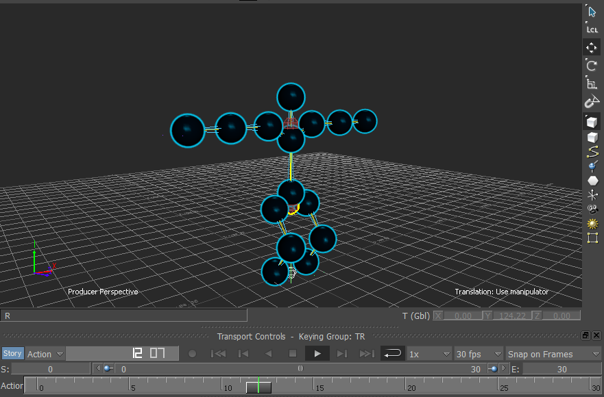

The FBPose class encapsulates MotionBuilder's ability to take a snapshot of characters (FBCharacterPose), and objects (FBObjectPose).
A character pose is created by invoking the FBCharacterPose() constructor. This adds an empty pose item in the scene's list of poses, as well as in MotionBuilder's Pose Controls UI element.
Given a reference to an FBCharacter in the scene (for example: FBApplication.CurrentCharacter), the FBCharacterPose.CopyPose() function stores the given character's pose into that FBCharacterPose object. Pose creation is illustrated in the code snippet below.
# Create poses of the character. def createPoses(pCharacter): poseList = [] # Create our first pose. pose1 = FBCharacterPose('myPose1') pose1.CopyPose(pCharacter) poseList.append(pose1) # Obtain a reference to the character's effectors. hipsEffector = pCharacter.GetEffectorModel(FBEffectorId.kFBHipsEffectorId) # Create our second pose. hipsEffector.Translation = FBVector3d(0, 50, 0) # (!!!) Note: It is very important to invoke FBSystem().Scene.Evaluate() # at this step to ensure the hipsEffector has effectively been translated. # Otherwise, it is not guaranteed that MotionBuilder's evaluation thread # will have translated the hips effector before pose2.CopyPose() is called. FBSystem().Scene.Evaluate() pose2 = FBCharacterPose('myPose2') pose2.CopyPose(pCharacter) poseList.append(pose2) # Repeat pose1 in our poseList to enable looping later. poseList.append(pose1) return (poseList)
The FBCharacterPose.PastePose() function applies the data contained in FBCharacterPose to the specified character. An instance of FBCharacterPoseOptions can also be specified to ensure the pose is mirrored, or to enable full-body keying mode. The code snippet below illustrates how to apply a list of poses to a character in the scene, and how to use these poses as animation key frames.
# Create keys from the pose list. def createKeys(pCharacter, pPoseList): # Ensure we take a pose of the entire character's body. poseOptions = FBCharacterPoseOptions() poseOptions.mCharacterPoseKeyingMode = FBCharacterPoseKeyingMode.kFBCharacterPoseKeyingModeFullBody poseOptions.SetFlag(FBCharacterPoseFlag.kFBCharacterPoseMirror, True) # Select the character's control rig (1st and 3rd parameter = True). This # allows FBPlayerControl.Key() to key the selected models. pCharacter.SelectModels(True, False, True, False) # Create a pose every 15 frames using our pose list. lPlayer = FBPlayerControl() poseCount = 0 frameInterval = 15 for pose in pPoseList: # Go to the next frame. lPlayer.Goto(FBTime(0, 0, 0, frameInterval * poseCount)) FBSystem().Scene.Evaluate() # Apply the pose to the character using our pose options. pose.PastePose(pCharacter, poseOptions) FBSystem().Scene.Evaluate() # Create a key in the player. lPlayer.Key() FBSystem().Scene.Evaluate() # Increment our counter. poseCount += 1 # De-select the character's control rig (1st parameter = False, 3rd parameter = True). pCharacter.SelectModels(False, False, True, False) # Return the frame number of the last frame keyed. return frameInterval * (poseCount - 1)
Program Summary: The following program builds on the program presented in FBCharacter - Characters. We define two new functions to make the character perform a looping "crouching" animation:
