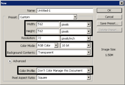

  2. Select File > New.
  3. In the New window that appears, set the following options and click OK.
    • Width: As required.
    • Height: As required.
    • Color Mode: RGB Color - 16 bit
    • Background Contents: Transparent
      (Creates an alpha channel for the image.)
    • Advanced > Color Profile: Don’t Color Manage this Document
      (Ensures the file is not tagged with an existing color profile.)
    A new blank image appears in the work area. A checkered background on the canvas indicates the presence of the alpha channel.
    Note:
    The Height and Width for a stamp image can range between 256 and 512 pixels, and must be square in proportion. For a stencil, the Height and Width can be non-square in proportion.

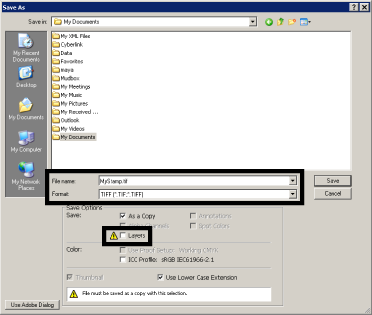

  5. Save the image by selecting File > Save As.
  6. In the Save As window, specify a filename for the image, set the following items, then click Save.
    • Format: TIFF
    • Layers: Off

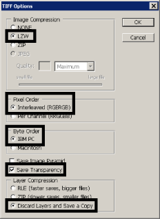

  7. In the TIFF Options window that appears, set the following, then click OK.
    • Image Compression: LZW
    • Pixel Order: Interleaved (RGBRGB)
    • Byte Order: IBM PC
    • Save Transparency: On
    • Layer Compression: Discard Layers and Save a Copy
