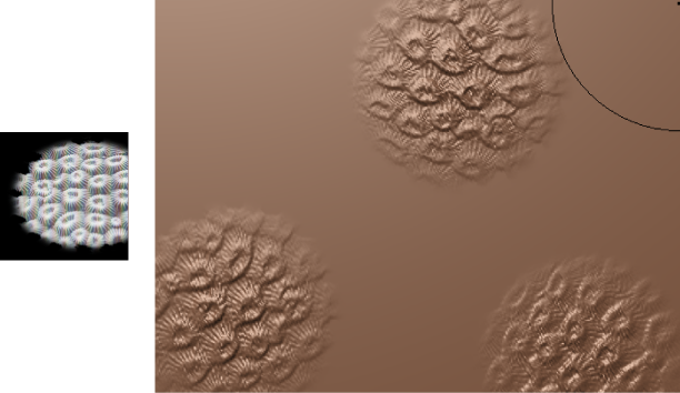

Sculpt using a repeating stamp image
- In the Sculpt Tools tray, select the Sculpt tool.
- In the Stamp tray, select a stamp image.
The stamp image appears in the Sculpt properties window with Use Stamp Image turned on.
- In the 3D View, stroke on the model to apply the stamp detail.

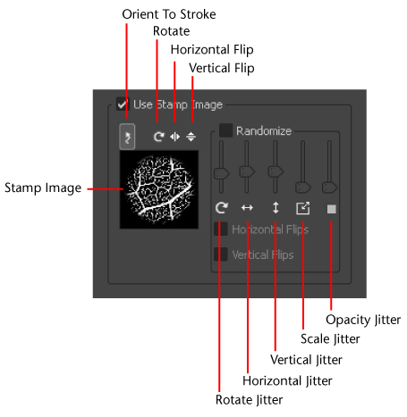

As you stroke, the stamp detail is applied and repeated along your stroke automatically. For more space between the individual stamps, increase the Stamp Spacing property in the Properties window. You can also have the stamp orient to the stroke path. See Sculpt Tool properties.
Note: A stamp or stencil image can reduce the strength of a sculpt tool depending on the amount of white in the image. White values in the image displace the vertices with full strength, while black values are not displaced at all. If the stamp or stencil image has a lot of gray tones, you may need to compensate by increasing the tool’s Strength property when using a stamp or stencil.

- Click an image in the Stamp tray to load it as a stamp and make it active on the currently selected sculpt tool (until you select another image or turn off the stamp image).
- Select an image using the Image Browser then click Set Stamp to copy the image path to the stencil.
