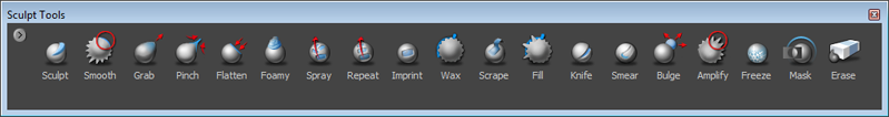

The preset Sculpt tools are an excellent starting point for most sculpting operations, but you can also edit the tool properties to suit your needs and save your custom version to the tool tray.
You can view and edit the properties for a sculpt tool as follows:
  1. Select a tool from the Sculpt Tools tray.
    The Properties window appears and displays all properties for the selected sculpt tool.
