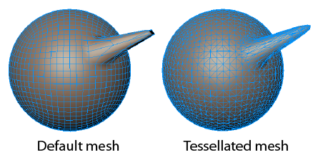

Generate Tessellation Mesh
Use this setting to creates a triangulated copy of your mesh for purposes of tessellation, which subdivides the mesh for sculpting in greater detail.
See Polygon Tessellation in the Sculpting Overview section for an explanation.
Note: When you try to sculpt a mesh that unsuitable for tessellating with any sculpting tool that has the Tesselation option active in any of the Sculpting Tool properties, Mudbox automatically offers to convert it.
