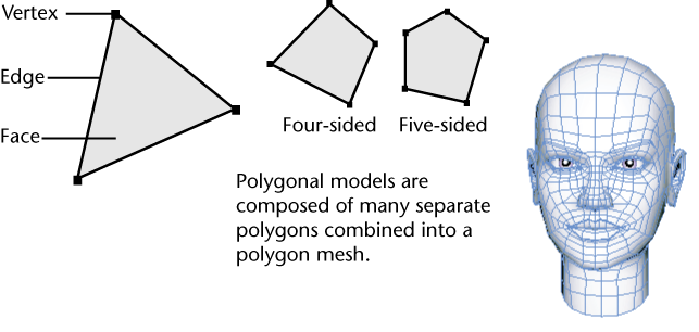

Polygonal meshes
Mudbox works with models that use polygons as the underlying surface type. Polygons are widely used in the development of 3D content for animated effects in film, video games, digital prototypes for industrial design, and for creating virtual 3D content for the Internet.
Polygons are comprised of straight-sided shapes (3 or more sides), defined by three-dimensional points (vertices) and the straight lines that connect them (edges). The interior region of the polygon is called the face. Vertices, edges, and faces are the basic components of polygons.
Many faces connected together create a network of faces called a polygonal mesh (also referred to as a polyset, polygonal object, or polygonal model). Polygonal meshes can be created in many 3D software applications (3ds Max, Maya, StudioTools, and so on), then exported for use within Mudbox.
Polygons represent complex 3D forms easily and accurately. They are simple to construct and easy to modify, with the right digital modeling tools. For these reasons they are ideal as the ‘digital clay’ in Mudbox.
