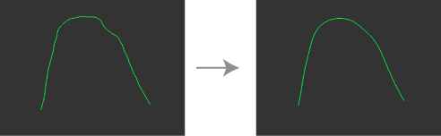

Smooth Curve |
Lets you smooth out bumps or jagged details on the curve by averaging the neighboring points. ![]() |
