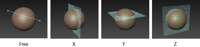

Plane
Available for the Curve Loop tool. See also Create precise 3D curves based on a plane.
By default, Plane is set to Free, which lets you add curves based on a line that you draw at any angle across the mesh.
To add curves perpendicular to a specific local or global axis, set Plane to the axis you want.

Available for the Curve Loop tool when Plane is set to a specific axis (not Free). When on, Mudbox snaps the preview plane to a numeric interval (specified in the Snap Distance field) as you click and drag to place curves. A HUD message displays as you drag to show the exact current position.
Snap Distance
(Available for the Curve Loop tool.) Lets you specify the interval at which to place curves as you click and drag with Snap turned on.
