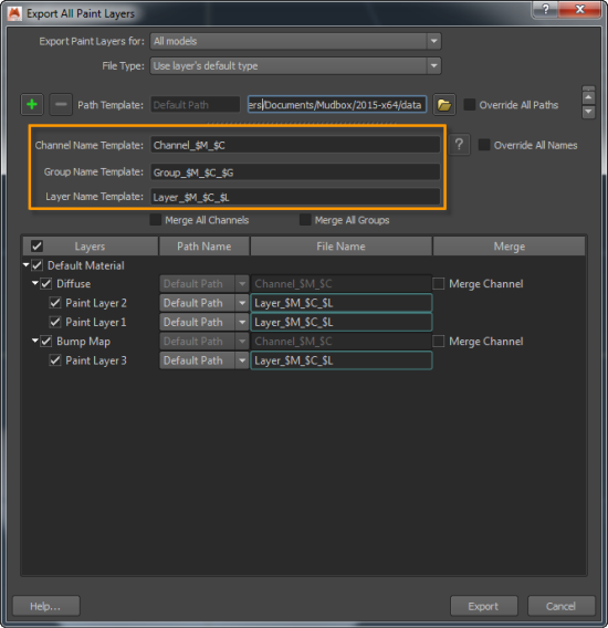

- Select File > Export All Paint Layers from the main menu bar.
- In the Export All Paint Layers window that appears, use the Export Paint Layers for drop-down list to select the model(s) whose layers you want to export:
- Select Active Model to export layers for only the last active model.
- Choose Selected Models to export layers for the selected model(s).
Note: The Active Model option updates to display the name of the active model, and Selected Models updates to display the number of selected models.
(Optional) To export a single image file per channel, turn on Merge All Channels. Mudbox merges all layers, then exports a single, merged layer for each channel.
(Optional) To export a single image file per group, turn on Merge All Groups. Mudbox merges all layers, then exports a single, merged layer for each group.
- Set any other file save options you want, including adjustments to the Channel Name Group Name, and Layer Name Templates, then click Export.
All paint layers for the selected model are saved in the directory you specified in the Export All Paint Layers window. By default, layers are saved to your Data directory.
To export all paint layers
- In the Export All Paint Layers window that appears, ensure that the Export Paint Layers for drop-down list is set to All Models.
Tip: When exporting all layers for multiple Ptex meshes that share the same material, add
$O to the Channel Name Group Name, and Layer Name Template fields in the
Export All Paint Layers options to ensure files for all objects are saved separately.
(Using the $O wildcard character appends the object name to each name.)
All paint layers in the scene are saved using the file naming convention and the directory you specified in the Export All Paint Layers window.
Setting Export Paths for Paint Layers, Groups, and Channels
You can set different export paths for paint layers, groups, or channels using the options in the File > Export All Paint Layers window. See instructions in the above procedures for exporting paint layers.
Mudbox remembers the export paths, so that you can repeatedly update texture files on the disk regardless of the target downstream application and whether or not the shaders are supported by Mudbox. If the target downstream application includes an automatic texture reload feature, then the textures edited in Mudbox take effect immediately.
You can merge channels or groups during the export without destructing the current paint layers setup. This offers flexibility for interactive painting workflows with custom or proprietary pipelines.
