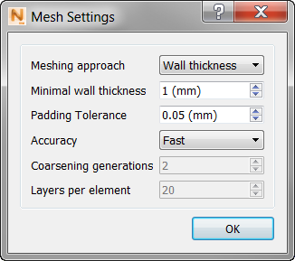

Mesh Settings
Specify the meshing approach, mesh density settings, and multiple STL padding tolerance.
The Padding Tolerance setting is used to fill in gaps that may occur between part and support structure, or any situation where multiple geometries are in contact. If gaps appear along the interface after the geometries have been meshed, increase the padding tolerance value, and each STL file will be expanded in all directions by this amount. Keep this tolerance value as small as possible to maintain dimensional accuracy of the original geometry. Padding tolerance applies to both meshing approaches.
Meshing Approach has two options, Wall Thickness and Layer Based.
Note: Each meshing approach controls the same voxel auto-mesher. The two options merely allow different methods of entering in the mesh control variables.
Wall Thickness
This Meshing approach is the more automated method. Selecting this approach requires two inputs:
Minimum wall thickness should be set to the thinnest cross section of the imported model or models. A larger thickness value produces a coarser mesh that will simulate faster; a smaller value produces a more accurate mesh, but the run time will be increased.
Accuracy controls the number of elements per minimum wall thickness and the number of mesh coarsening generations allowed. The four options shown in the following table allow for a number of choices that balance model accuracy with speed of rendering:
Accuracy Elements per minimum wall thickness Coarsening generations
Most Accurate 4 0
Accurate 3 1
Fast 2 2
Fastest 2 3

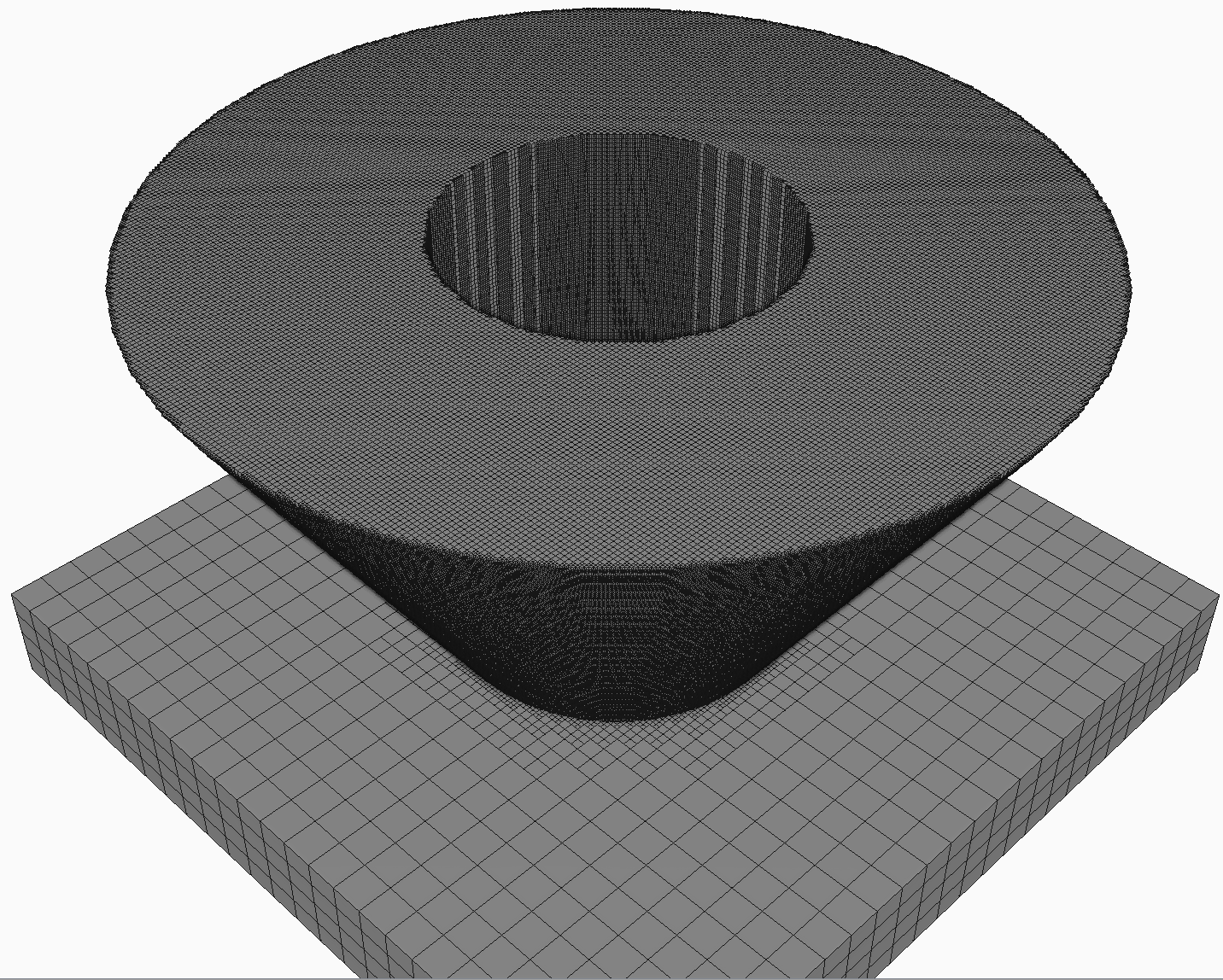

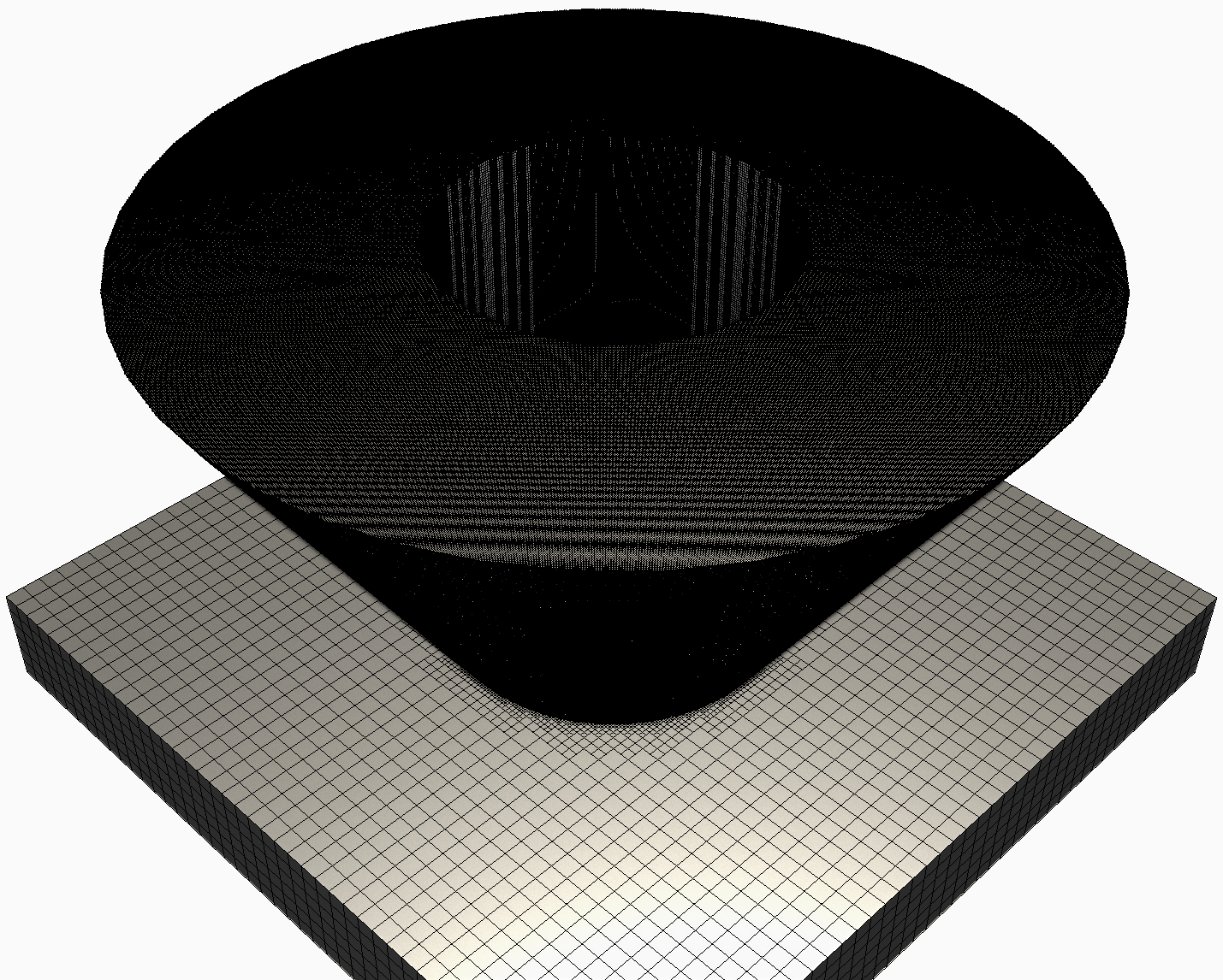

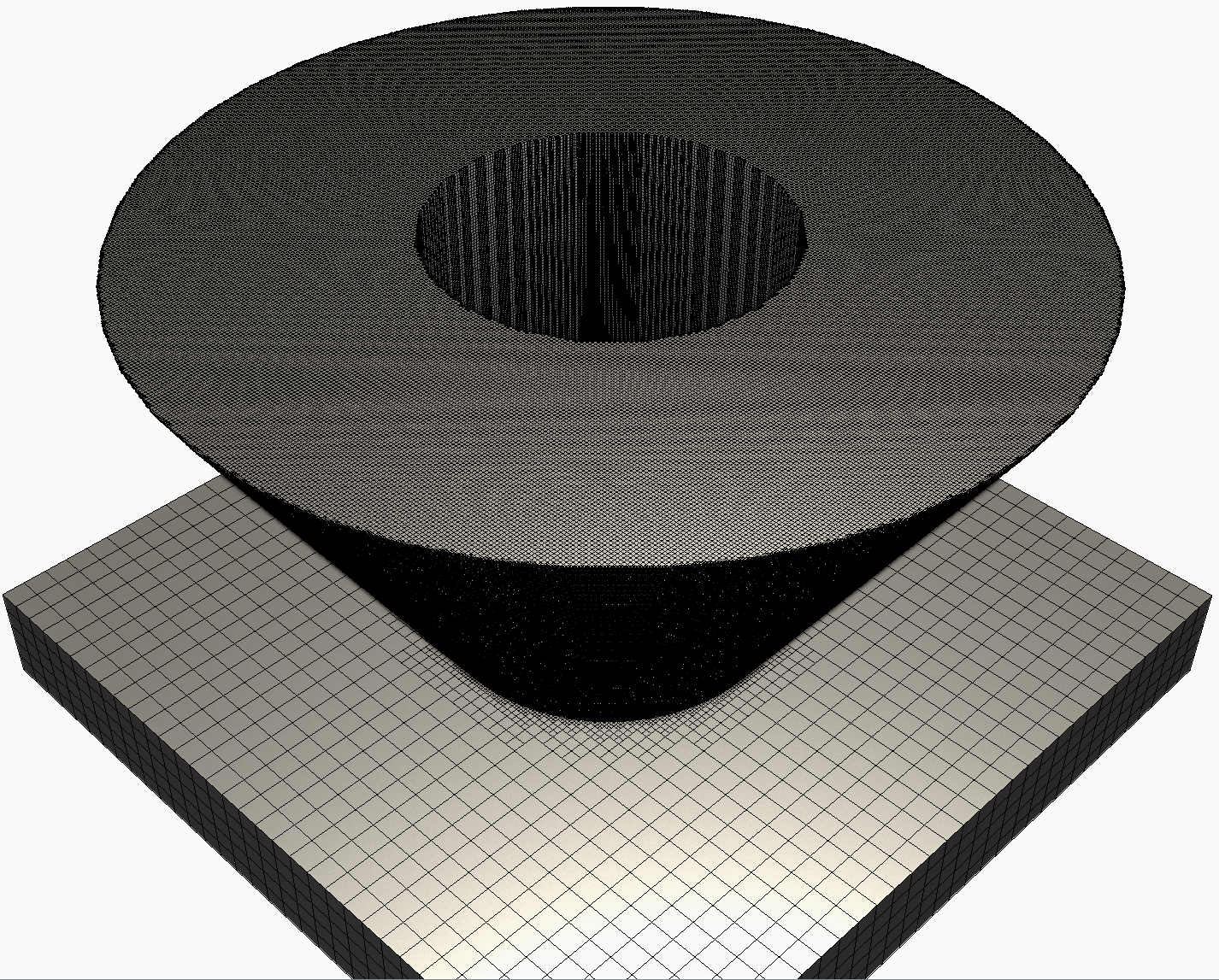

The results of the four meshing approaches for small geometry are shown below, with each mesh figure clipped around 90% of the maximum height of the part, to show the interior of the mesh, where coarsening is allowed:
Fastest Fast Accurate Most Accurate
894468 Nodes 894468 Nodes 1824744 Nodes 3621073 Nodes
22361700 Elements 460488 Elements 971538 Elements 1917649 Elements
4430 s Projected run time 7530 s Projected run time 41900 s Projected run time 207000 s Projected run time
