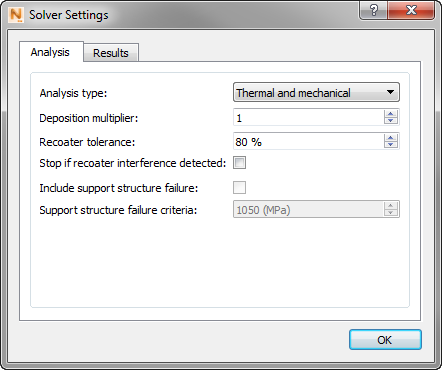

  3. Click Home tab > Solver Settings > Analysis tab.
    Note that Deposition multiplier has a default value of 1. This means that the simulation will account for only the part or parts on the build plate. We will first solve the simulation with this setting.

  6. Go back to Home tab > Solver Settings > Analysis tab and change the Deposition multiplier setting to 4. The simulation will account for the building of 4 parts on the build plate, and extend the timeline accordingly.
