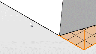

To Measure an Angle
Measuring angles includes measuring adjacent ones. To get these displayed, an additional step is needed.
  1. From the main menu, choose Analyze > New Measurement.
  2. In the context area, select 3-Point Angle, or Line > Angle Edge-Edge.
  3. Click on the part to add measurement endpoints as needed.
  4. Move the mouse pointer around the vertex of the created angle measurement to switch through the available arcs of angle measurement.
    Measuring adjacent angles
  5. Click to confirm the chosen arc.
