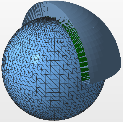

    Initially, the surface is extruded a distance of 1 mm normal to the surface. The extruded surface is colored gray.
  4. In the context area, switch to 3D-Extrude.
  5. Click and drag the gray colored surface to adjust the extrusion height as necessary, or use the Shift slider.
  6. Enable one of the following extrusion types:
    • Real Extrusion: Creates new triangles to create the extrusion.
    • Move Points: Moves the points of the selected triangles, rather than creating new triangles.
    • Thickening: Increases the thickness of the selected triangles.
