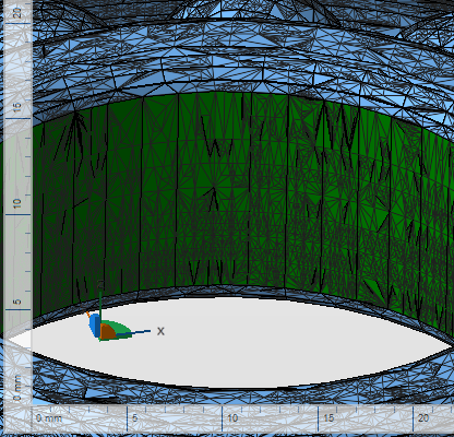

Many of these tools require, or allow, a selection of triangles to work on.
A highly irregular mesh is partly selected in preparation for remeshing.
