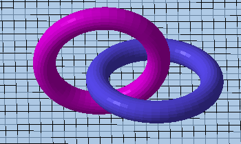

Use the Monte Carlo Packer for packing jobs with a large number of parts, or when you are concerned about interlocking. The Monte Carlo Packer prevents interlocking.
An example of two interlocking tori that can’t be separated.
