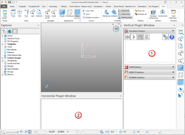

You can add plugins to
PowerMill to tailor a machining solution to your requirements. Plugins are developed outside of the main
PowerMill application but are designed to fully interact with it. Plugins are either displayed in the horizontal plugin window or the vertical plugin window (you cannot change where a plugin is displayed).
Vertical plugin window
Horizontal plugin window
If a plugin window is not displayed, click View tab > Window panel > User Interface > Vertical Plugin Window or Horizontal Plugin Window.
