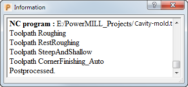

    PowerMill first calculates all the batched toolpaths, then it postprocess the toolpaths using the pre-selected options.
  2. When it has postprocessed the toolpaths, PowerMill displays an information dialog. Click to close the Information dialog.
If the NC program is calculated correctly, it changes from light blue to bright green .
