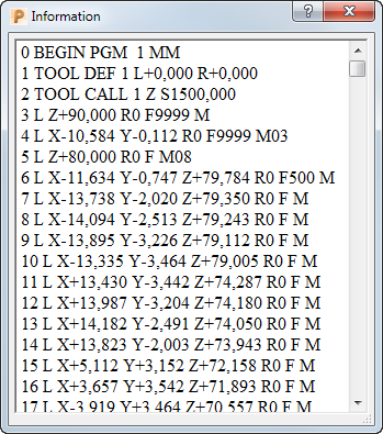

- View — Click to display a postprocessed NC Program file in an information dialog. For example:
