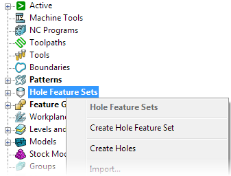

Use the Hole Feature Sets menu to create and manage hole feature sets in the current project.
To display the menu, in the Explorer, right-click Hole Feature Sets.
Hole Feature Sets — The name of this menu.
Create Hole Feature Set — Select to create a Hole Feature Set in the Explorer.
Create Holes — Select to create holes, using the Create Hole dialog. For more information see Creating holes from a model.
Import — Select to read-in holes from an *.xml file. It displays the Open XML File dialog.
Export — Select to save holes as an *.xml file. It displays the Export Feature Set dialog.
