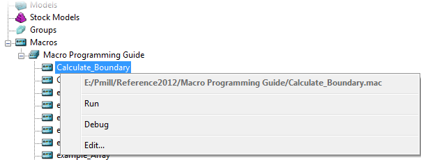

Individual Macro menu
Use the individual Macro menu to run, debug, and edit the macro.
To display the menu, in the Explorer, right-click an individual macro.
E:\Pmill\Reference2012\Macro Programming Guide\Calculate_Boundary — The name of the selected macro.
Run — Click to run the macro. Each step in the macro is carried out one after the other.
Debug — Click to open the Macro Debugger. The function enables you to test, debug, step-through and track variable values in your macro.
Edit — Click to add to, or correct the macro.
Note: By default, macro (.mac) files are opened in Windows WordPad. To specify a different editor, from the Windows Control Panel, select Default Programs.
