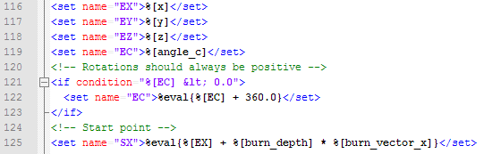

Editing a script
The following example demonstrates how to edit a standard manufacturer script. The same concepts apply to editing a custom script.
To edit a script:
  1. Open the script using a text editor.
  2. Enter your changes to the script, using the appropriate script language.

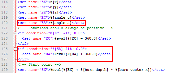

    In this example, a new variable EA is defined, and its value is specified by the substitution string %[angle_a]. If the substitution string returns a value that is less than zero, the variable is recalculated to be its current value plus 360. This ensures that the angle is positive.
  3. Save the file to apply your changes.
    Save the file to the shareddb directory to ensure these changes will be used when a new version of PowerShape is installed.
