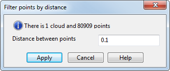

  2. Click Cloud Tools tab > Selection panel > Filter Points to display the Filter points by distance dialog:
    The number of clouds and number of points in the selected clouds is displayed.
  3. Enter the Distance between points. After filtering, no point lies within this distance of any other point.
