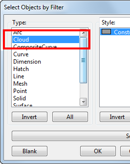

- Home tab > Selection panel > Filter option, and select the
Cloud
option in the
Selection Filter
dialog:
