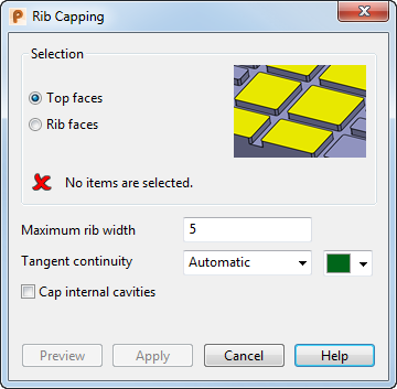

  2. Use the Rib Capping dialog to create capping surfaces:
  3. Choose a capping option. Select either:

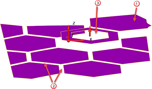

    • Top faces to select faces of your solid or surfaces that are adjacent to the ribs you want to cap. Hold down the Shift key and click each face or surface, or click and drag a box over the selection.
      For example:
      — The selected Top faces that the capping surfaces will be created between are highlighted. A graphical arrow appears at the centre of the selection showing the direction of the current principal plane.
      — Ribs to be capped.
      — Internal cavity (see below).
    • Rib faces to select the faces of your solid or surfaces that make up the ribs. Hold down the Shift key and click each face in turn to select an area.
      For example:
      — The selected Rib faces that will be capped are highlighted.
    In the Rib Capping dialog, the changes to a and No items are selected is replaced by a message specifying the selected number of faces or surfaces.

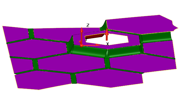

  5. Click Preview to display the capping surfaces, for example:
    If the operation fails, the error message No rib surfaces created or Input faces were unusable is displayed at the bottom of the dialog.

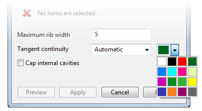

  6. Enter the Maximum rib width. Gaps exceeding this distance are not treated as ribs.
  7. From the Tangent continuity list, select the style of surface continuity for the capping surfaces when there is a step across a rib:
    • Automatic — makes the capping surfaces tangent-continuous with respect to the lower face, generating a larger radius of curvature on the lower side of the rib.
      This option also relaxes the tangent continuity condition if any problems are detected in the faces.
    • Lower — makes the capping surfaces tangent-continuous with respect to the lower face, generating a larger radius of curvature on the lower side of the rib.
    • Both —makes the capping surfaces tangent-continuous with respect to both faces, generating a smooth transition in tangent direction as you move between the upper and lower faces on either side of the rib.
    • None — the capping surfaces are not tangent-continuous with any surrounding face, producing a straight surface.
      Automatic
      Lower
      Both
      None
  8. To change the colour of the rib surfaces, select an option from the drop-down list:
  9. If you want to create capping surfaces for internal cavities that exceed the Maximum rib width, select Cap internal cavities:
