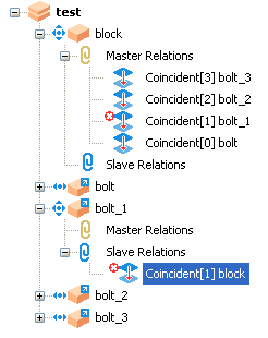

To display the
Relation
context menu, right-click one of the following in the assembly tree:
- Master Relations branch
- Slave Relations branch
- the relation (for example, Coincident,
Perpendicular)

A
icon appears next to the master and corresponding slave relation, to indicate it is suppressed:
To add the relation back, right-click the relation again in the assembly tree and select
Suppressed.
