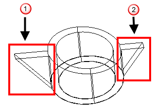

  2. Box select the areas marked and .

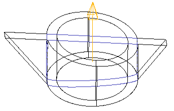

    When the parts of the region on each side of the missing geometry are selected, the wizard detects they can be joined and adds instrumentation to the joining wireframe.
  3. Click on the instrumentation to automatically generate the missing geometry and add it to the electrode selection.

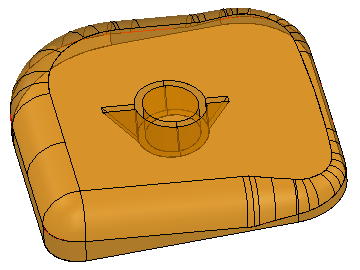

  4. Click Finish to create the electrode.
