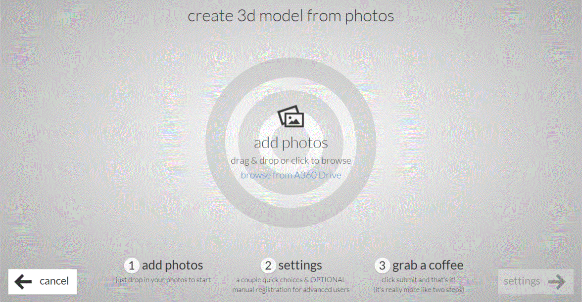

Importing Photos
You will need to add at least 6 JPEG photos to begin your project; however, for best project results, ReCap Pro recommends uploading at least 20 images.
ReCap Pro's capabilities for photogrammetry include a maximum import of 250 images.
After import, you can immediately view your images in Tiled View, which has a slider to quickly resize your group:
When you are satisfied with your import, you will then have the option to add or delete images, and be ready to use ReCap Pro's exclusive Photo-to-3D engine.
