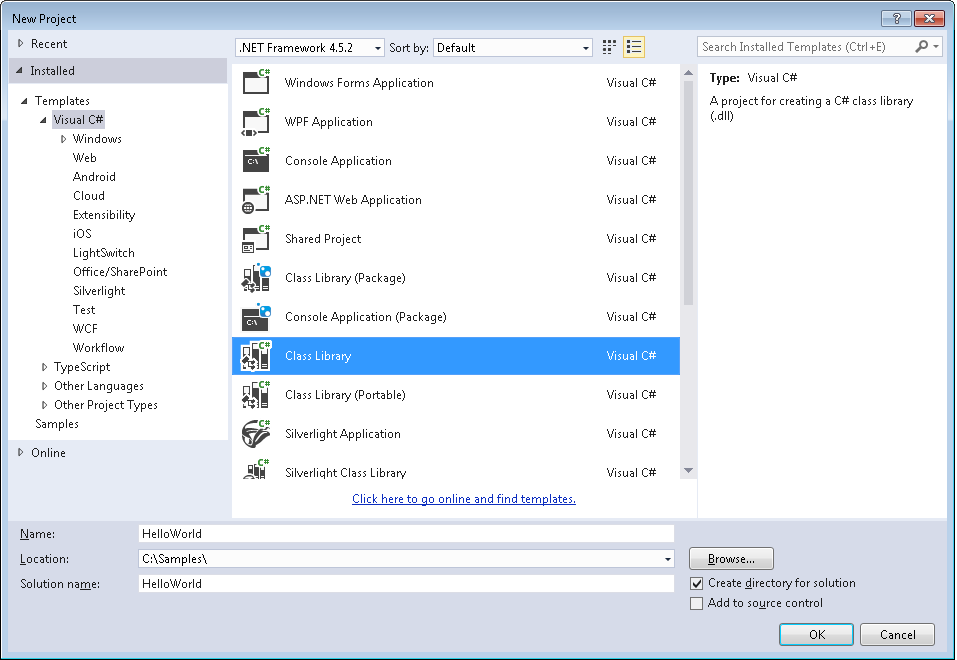

The first step in writing a C# program with Visual Studio is to choose a project type and create a new Class Library.
  1. From the File menu, select NewProject….
  2. In the Installed Templates frame, click Visual C#.
  3. In the right-hand frame, click Class Library (see Figure 1: Add New Project below). This walkthrough assumes that the project location is: C:\Samples.
  4. In the Name field, type HelloWorld as the project name.
  5. Click OK.

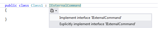

Tip: The Visual Studio Intellisense feature can create a skeleton implementation of an interface for you, adding stubs for all the required methods. After you add ":IExternalCommand" after Class1 in the example above, you can select "Implement IExternalCommand" from the Intellisense menu to get the code:
Figure 2: Using Intellisense to Implement Interface
Every Revit add-in application must have an entry point class that implements the IExternalCommand interface, and you must implement the Execute() method. The Execute() method is the entry point for the add-in application similar to the Main() method in other programs. The add-in entry point class definition is contained in an assembly. For more details, refer to Add-in Integration.

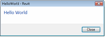

    TaskDialog.Show("Revit", "Hello World");
  6. Press F5 to start the debug procedure.
Test debugging:

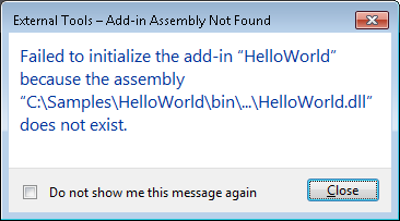

Q: Why is there no Add-Ins tab or why isn't my add-in application displayed under External Tools?
A: In many cases, if an add-in application fails to load, Revit will display an error dialog on startup with information about the failure. For example, if the add-in DLL cannot be found in the location specified in the manifest file, a message similar to the following appears.
Figure 6: External Tools Error Message
In this case, ensure that the .addin file has the correct path to the assembly.

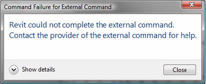

Q: Why does my add-in application not work?
A: Even though your add-in application is available under External Tools, it may not work. This is most often caused by an exception in the code.
Revit will display an error dialog with information about the exception when the command fails.
Figure 7: Unhandled exception in External Command
This is intended as an aid to debugging your command; commands deployed to users should use try..catch..finally in the example entry method to prevent the exception from being caught by Revit. Here is an example:
