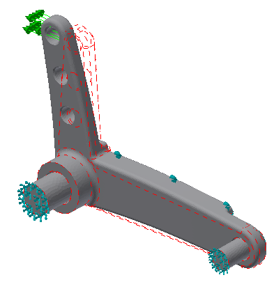

Deformation
The primary use of the deformation plot is to show how the part or assembly changes shape in response to applied loading. To show deformation, in the Results branch of the tree, right-click Deformed > Display.
To control the deformation plot, in the Results branch right-click Deformed > Edit and in the Plot dialog, click the Deform Options tab. Be sure the Vector is set to Displacement and the Type to Total:
