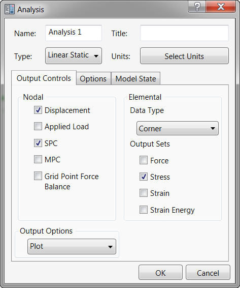

When you first start the Autodesk Nastran In-CAD environment, the analysis feature has certain default settings. To modify these settings, on the Analysis tree, right-click Analysis > Edit. To create a new analysis, right-click the Part or Assembly at the top of the tree, and select New Analysis. In both cases, the Analysis dialog opens:

Nodal Output Control / Elemental Output Control
You can use the Nodal Output Control and Elemental Output Control options to control the quantities written out at the conclusion of the analysis.
For more information, please see the New Analysis topic.
