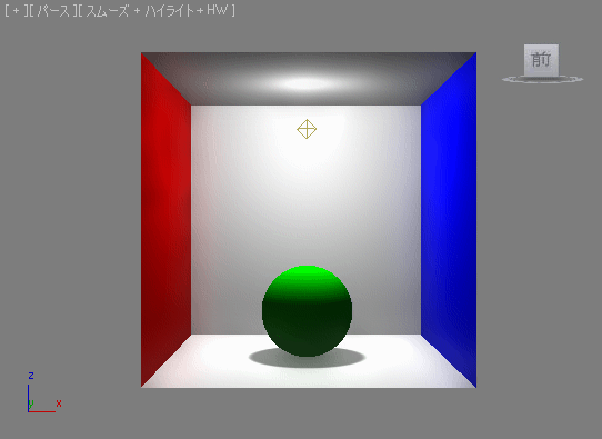

コーネル ボックスの例:
resetMaxFile #noPrompt
viewport.setTM (matrix3 [1,0,0] [0,0,-1] [0,1,0] [6,-150,-800])
bx = box width:300 height:300 length:300 backfacecull:true
addModifier bx (normalModifier flip:true)
mtl = multiMaterial numsubs:6
mtlred = standard diffusecolor:red
mtlblue = standard diffusecolor:blue
mtlwht = standard diffusecolor:white
mtl.materialList = #(mtlwht,mtlwht,mtlred,mtlblue,mtlwht,mtlwht)
bx.material = mtl
om = omniLight pos:[0,0,250] rgb:white shadowMultiplier:0.5
om.baseobject.castshadows = true
sph = sphere radius:50 pos:[0,0,50] segs:32
sph.material = standard diffusecolor:green selfillumamount:15.0
vss = maxops.getViewportShadingSettings()
vss.ActivateViewportShading = true
vss.ShadowsActive = true
vss.IndirectLightingRadius = 200
vss.IndirectLightingQuality = #medium
vss.IndirectLightingMode = #ILAOComposite
結果:

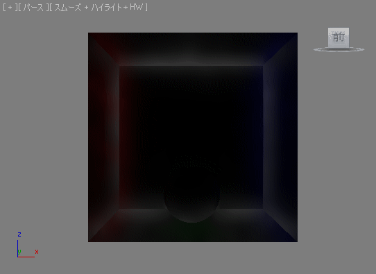

vss.IndirectLightingMode = #ILOnly
結果(間接光のみ)

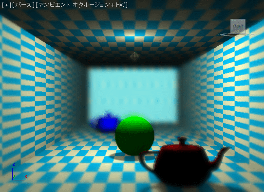

DOF ボックスの例:
bx = box width:500 height:300 length:2000 backfacecull:true
mp1 = checker color1:[0,200,255] color2:[255,255,200]
mp1.coords.U_Tiling = 10
mp1.coords.V_Tiling = 10
bx.material = standard diffusecolor:white diffusemap:mp1
showTextureMap bx.material mp1 true
tp1 = teapot radius:50 pos:[80,-250,0]
tp1.material = standard diffusecolor:red
tp2 = teapot radius:50 pos:[-100,500,0]
tp2.material = standard diffusecolor:blue
vss.ShadowMode = #Soft
vss.AmbientOcclusionMode = #AOComposite
vss.DepthOfFieldActive = true
vss.DepthOfFieldNearPlane = 300
vss.DepthOfFieldFarPlane = 1500
vss.DepthOfFieldFocusPlane = 800
結果:
