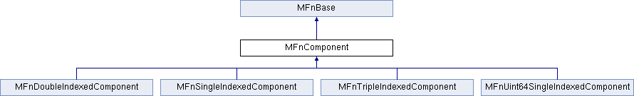

Inheritance diagram for MFnComponent:Public Member Functions | |

Reimplemented in MFnDoubleIndexedComponent, MFnSingleIndexedComponent, MFnTripleIndexedComponent, and MFnUint64SingleIndexedComponent.
