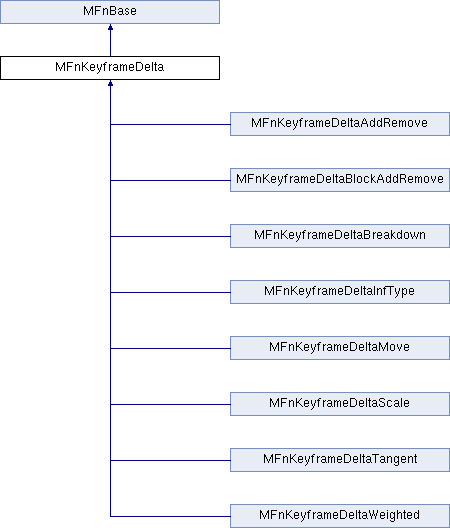

MFnKeyframeDelta Class Reference
#include <MFnKeyframeDelta.h>
Base function set for keyframe deltas.
Keyframe delta objects are returned via the MAnimMessage::animKeyframeEditedCallback( ... ). They describe atomic changes to keyframes as a result of a curve edit operation. Refer to the documentation in MAnimMessage class for further information.
Base function set for all keyframe delta objects. A keyframe delta object is generated from the MAnimMessage::addAnimKeyframeEditedCallback.
