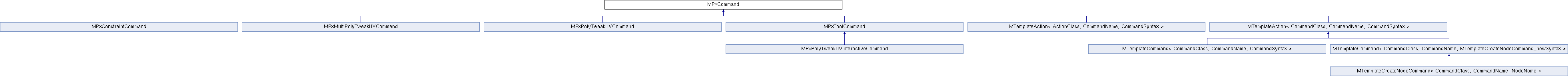

Inheritance diagram for MPxCommand:Public Types | |
