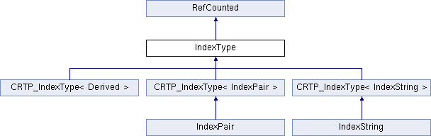

IndexType Class Reference
#include <adskDataIndexType.h>
Complex index type for referencing metadata.
adsk::Data::Stream objects contain a list of data elements. Each element has to be accessed by Index. This is the base class for the complex index types.
Copy constructor, simplest level.
