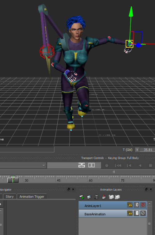

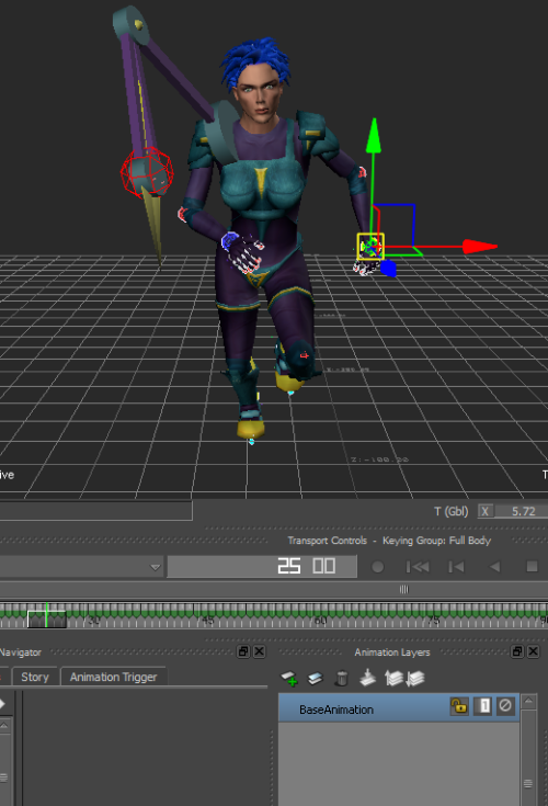

Effectors are also called Inverse Kinematics (IK). Effectors are used in MotionBuilder to easily manipulate a character skeleton and achieve realistic animation. Effectors jointly influence the corresponding bones in a skeleton. The influence of an effector on the bones is adjusted using the IK Blend and IK Pull.
Blend is used for measuring how much the corresponding bone reaches the effector without pulling the whole body. Pull works when the bone cannot reach the effector. It measures how much the corresponding bone pulls the body to the effector. Refer to the MotionBuilder online help for more information about the IK Blend and IK Pull.
To follow the instructions in this topic, download the files and script from http://area.autodesk.com/downloads/scripts/motionbuilder-animation-scripts.
The manipulate_ik.py script shows how to modify the animation using effectors. Run the manipulate_ik.py script step by step as explained in the following section:

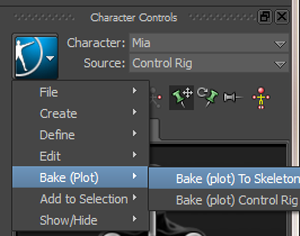

Characters can store animation in the skeleton and control rig. The skeleton and control rig have many bones (joints) that contain animation in the T, R, and S channels (also called FCurve node). The FCurve node contains the x, y, and z FCurves, which contain the keys with the value, time, and key type information. In character plotting, the keys are copied and pasted frame by frame from one FCurve to the other.
The UI option for plotting is shown in the following figure.
The FBCharacter::PlotAnimation() function is used for plotting in the SDK.

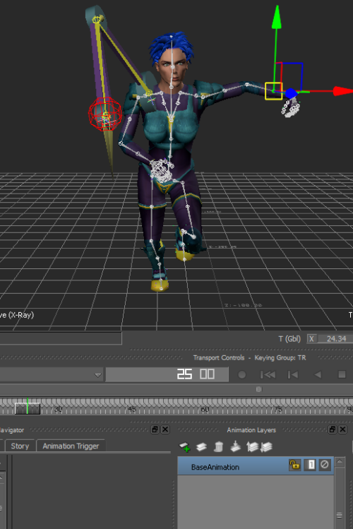

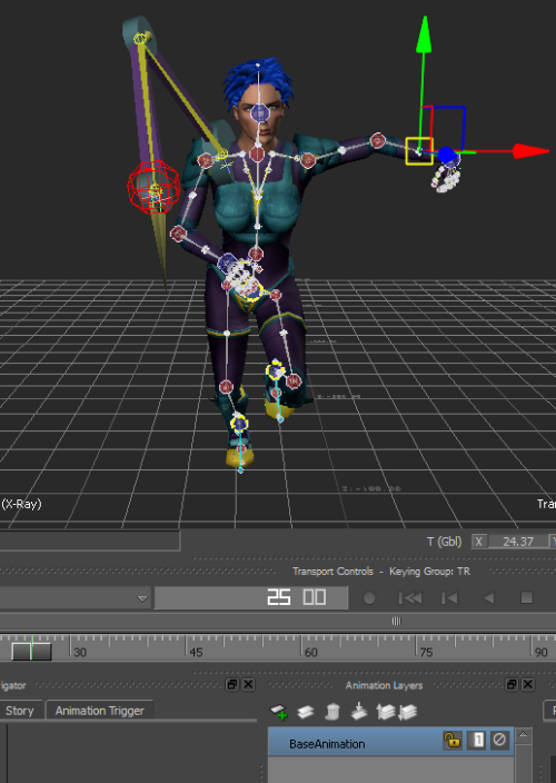

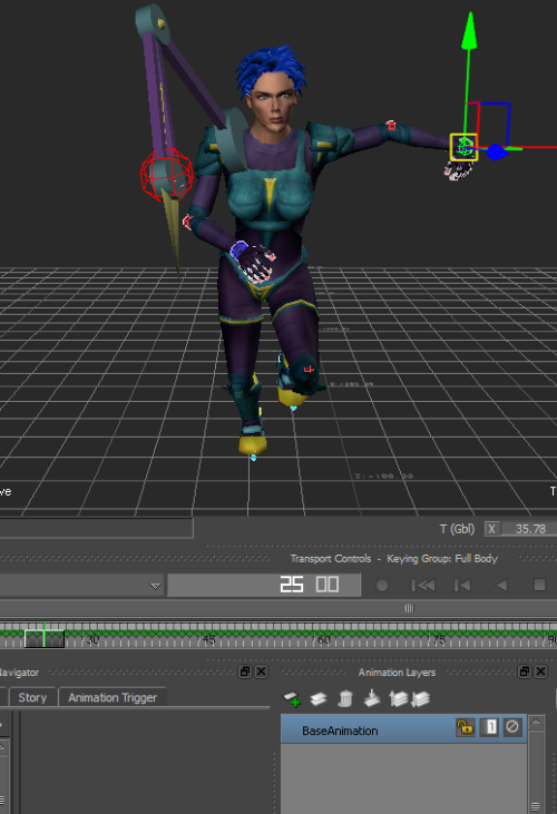

Continue the scene in the Modifying Character Animation using Effectors section. Follow these steps to merge and plot the character animation to the control rig and skeleton.

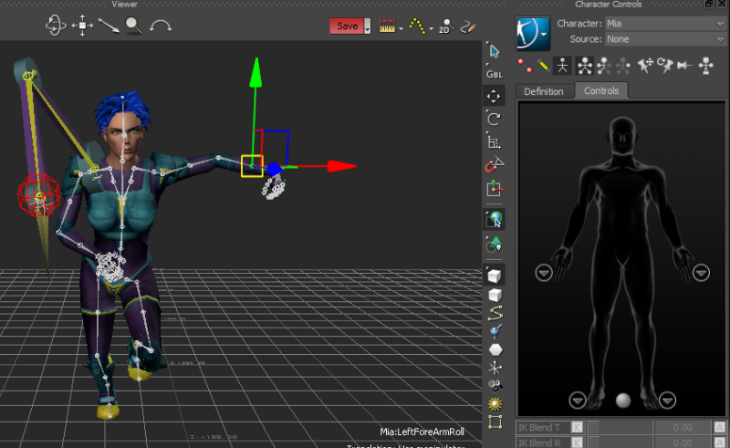

Select a bone in the skeleton. You will not find any animation.
Now, you can see that the bone for the character (LeftForeArmRoll) contains animation as shown in the following figure. If you select the character's input to None (usually, the input is automatically changed to None), the character still moves when played. It indicates that the animation is plotted to the skeleton, and the character does not require any input to move.
