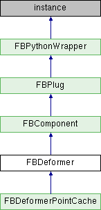

Base Model deformer class.
Inheritance diagram for FBDeformer:Public Member Functions | |
