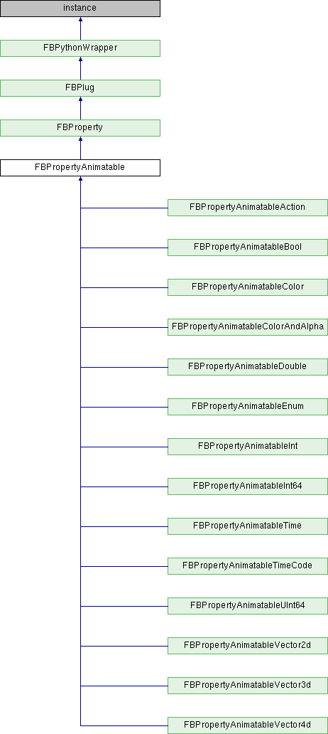

Animatable property base class.
Inheritance diagram for FBPropertyAnimatable:Public Member Functions | |
