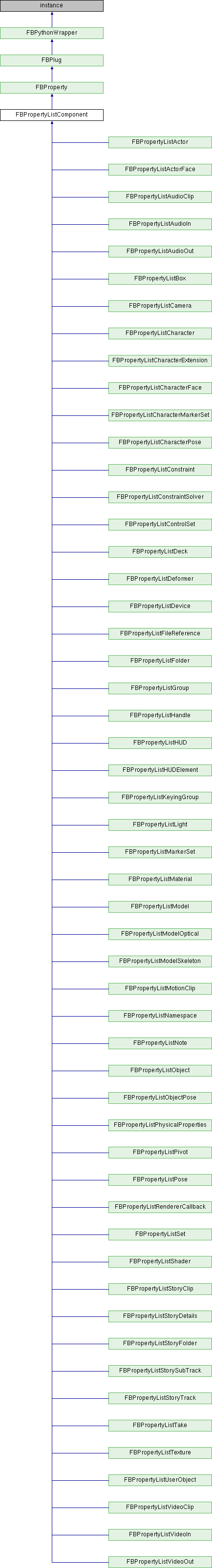

PropertyList: Concrete class for PropertyList of component
# Supported list protocol methods:
len(propertyListComponent)
component= propertyListComponent[0]
propertyListComponent[0] = my_component
if my_component in propertyListComponent:
print "it is contained!"
del propertyListComponent[0]
