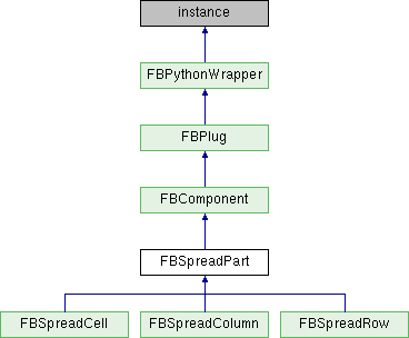

Inheritance diagram for FBSpreadPart:Public Member Functions | |
