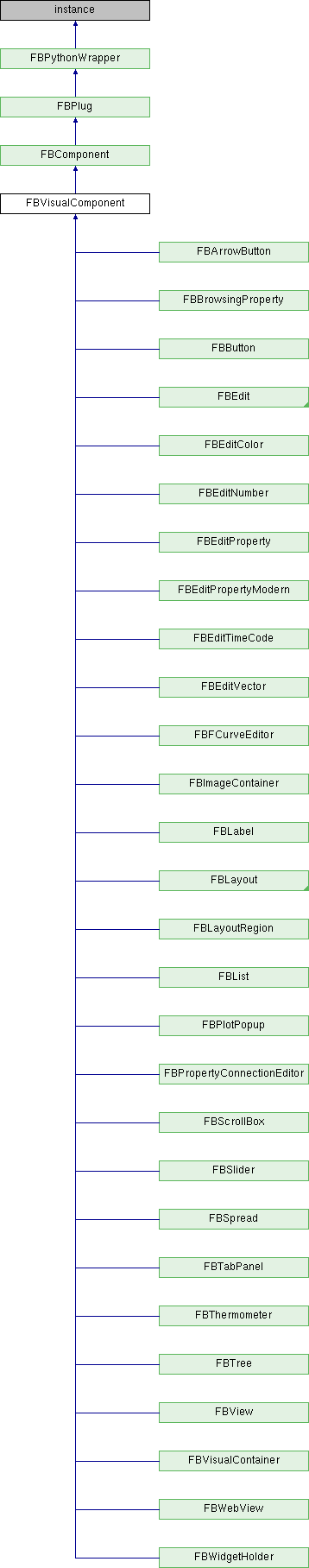

Inheritance diagram for FBVisualComponent:Public Member Functions | |
