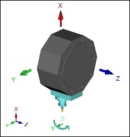

Motion axes are defined in the Machine Data dialog for each machine component. They specify the directions in which a machine component can move. Enabling the X, Y, or Z motion axis allows the machine component to move in that axis during simulation. The B-axis applicable to the tool head and turrets allows the machine component to rotate about the Y-axis. The B-axis applicable to the gang allows a rotary attachment to rotate about the X or the Y axis (as specified on the Rotary Attachment dialog).

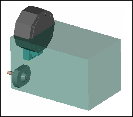

Travel limits specify the limiting coordinates of the machine, beyond which the reference point of the machine component cannot travel. PartMaker checks that the reference point of the machine component is contained within the region bounded by the travel limits.
The availability of the travel limits depends on the motion axis of each machine component.

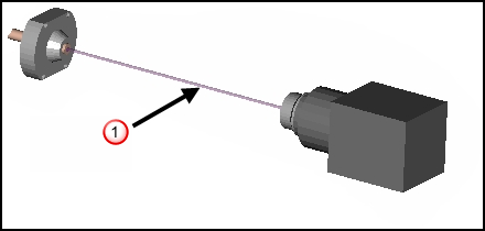

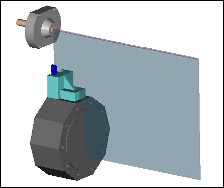

There are three ways to define travel limits:
